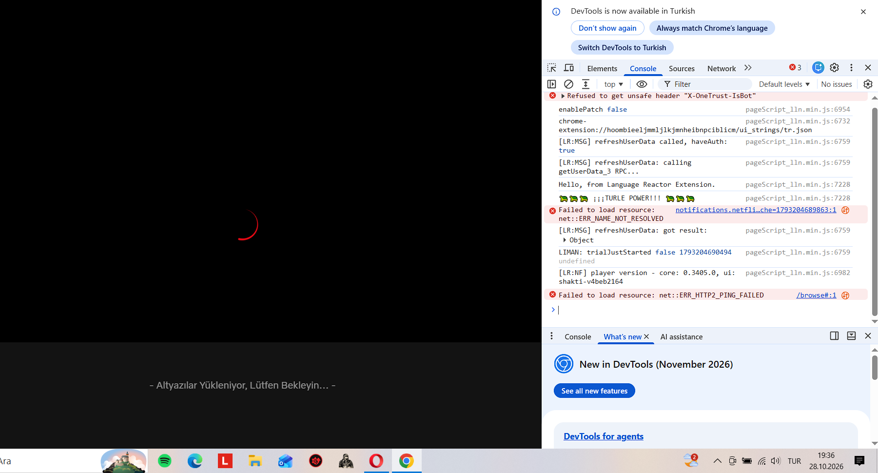

hi ı am using opera, it happens on chrome too, no ım not using vpn, and i will check if it happens in incognito mode and here is the screenshot

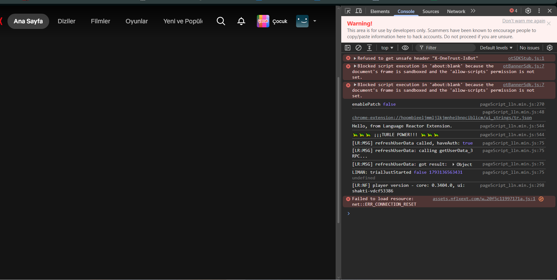

hey yana it’s still happening and ı deleted my goodbydpı and full reset to my dns.
görsel_2026-10-28_194054011
when ı ask gemini it says its language reactor. when I disable language reactor everything works though

The console shows failed requests to Netflix’s own servers (connection reset, DNS not resolved, HTTP/2 ping failed), which may point to something interfering with the connection. Since you mentioned that you’ve already removed GoodbyeDPI and reset your DNS, please make sure GoodbyeDPI is fully gone: deleting the folder isn’t enough if its service is still installed. Open Command Prompt as administrator and run sc query goodbyedpi. If it says the service doesn’t exist, you’re fine. If it exists and you no longer use GoodbyeDPI, run sc stop goodbyedpi and then sc delete goodbyedpi, then reboot. (Note: sites that were only reachable through GoodbyeDPI may stop opening after this)
Also check whether similar tools (Zapret, SpoofDPI, a VPN, or antivirus web protection) are running. You can turn them off temporarily for the test, but please turn your antivirus protection back on afterwards.
If it still happens, please open the Network tab (tick “Preserve log”) with Language Reactor enabled, reload Netflix, wait about 30 seconds, and send a screenshot where the red (failed) requests are visible. Then do the same with Language Reactor disabled so we can compare.
