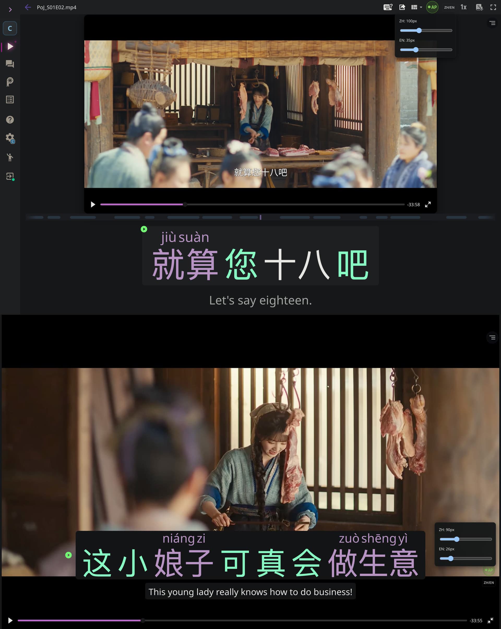

One thing I keep wanting in the web player is control over subtitle font size, independently for the learning-language line and the translation line. The current fixed sizing is too small for me on a large screen, and there is no setting to change it.
Rather than just ask, I built a working Tampermonkey userscript that does it, so you can see exactly what I mean and (hopefully) fold it in natively. What it does:
  • Adds a small button next to the Auto-pause control that opens a panel with two sliders: learning-language size and translation size.
  • Remembers both sizes across sessions.
  • Works in both the normal player and fullscreen mode.
  • Also fixes subtitle centering/alignment and removes the background box behind the text.
Full script is below. It is about 100 lines, MIT licensed, do whatever you like with it. The CSS selectors (.media-wrap .dc-orig, .dc-translit, .main-translation-wrap, etc.) are obviously tied to the current DOM, so it is meant as a reference for a native implementation, not a long-term hack.

Hi @Atcold, thank you for taking the time to do this. This is a really useful feature for MediaFile. I’ve passed this along to the team so they can discuss it!
Thanks, @Yana!
Let me know if I can contribute to your code base.
I can help with more improvements, if you like my work!
Atcold
@Atcold sure, as soon as the team gets back to me, I’ll get in touch with you! :dizzy:
