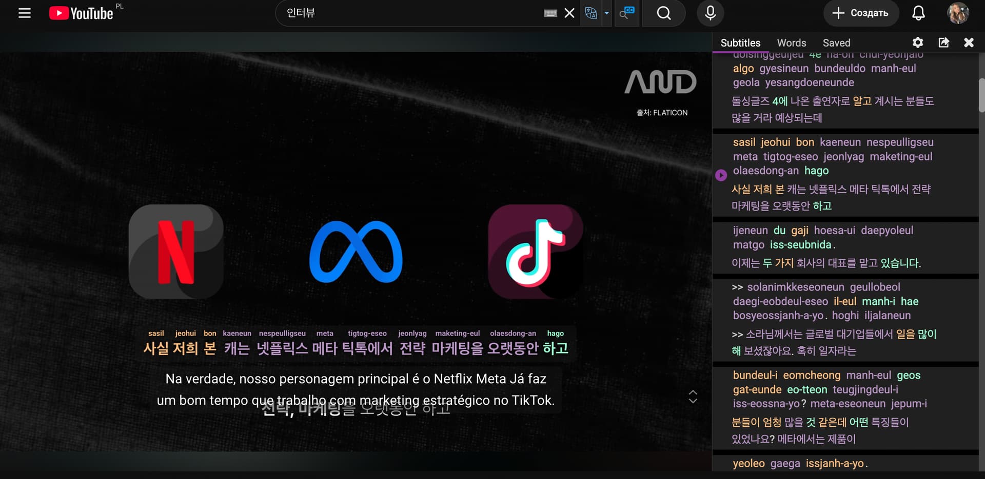

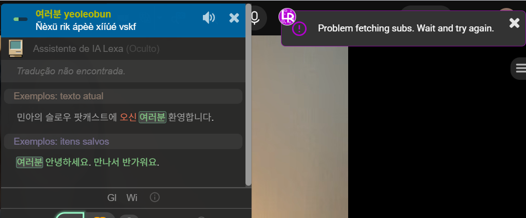

Since yesterday, I’ve been experiencing an issue with korean subtitles on YouTube and Netflix. The message “Problem fetching subs. Wait and try again.” appears on every video and words are not being translated into my language (brazilian portuguese), and the AI Assistant is also not working.

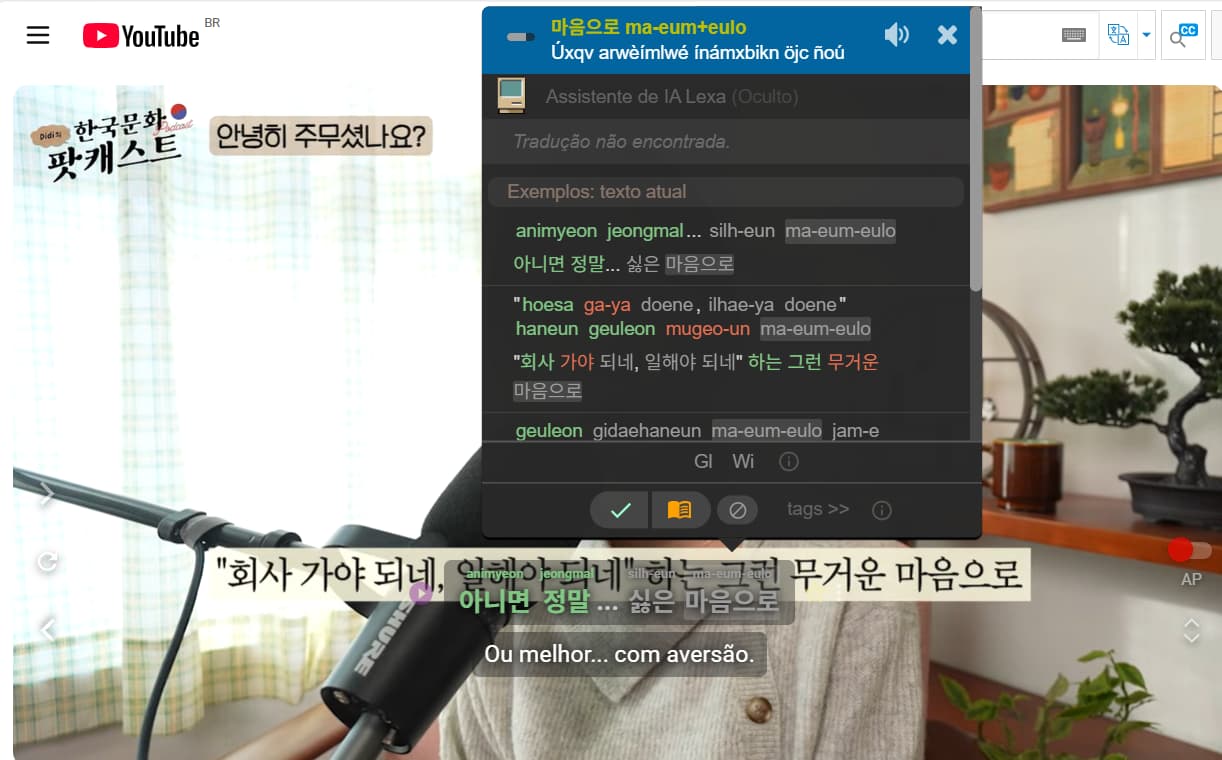

I also tested other languages, not just Korean, and the problem still occurs. The problem occurs when I click on words to find the meaning.

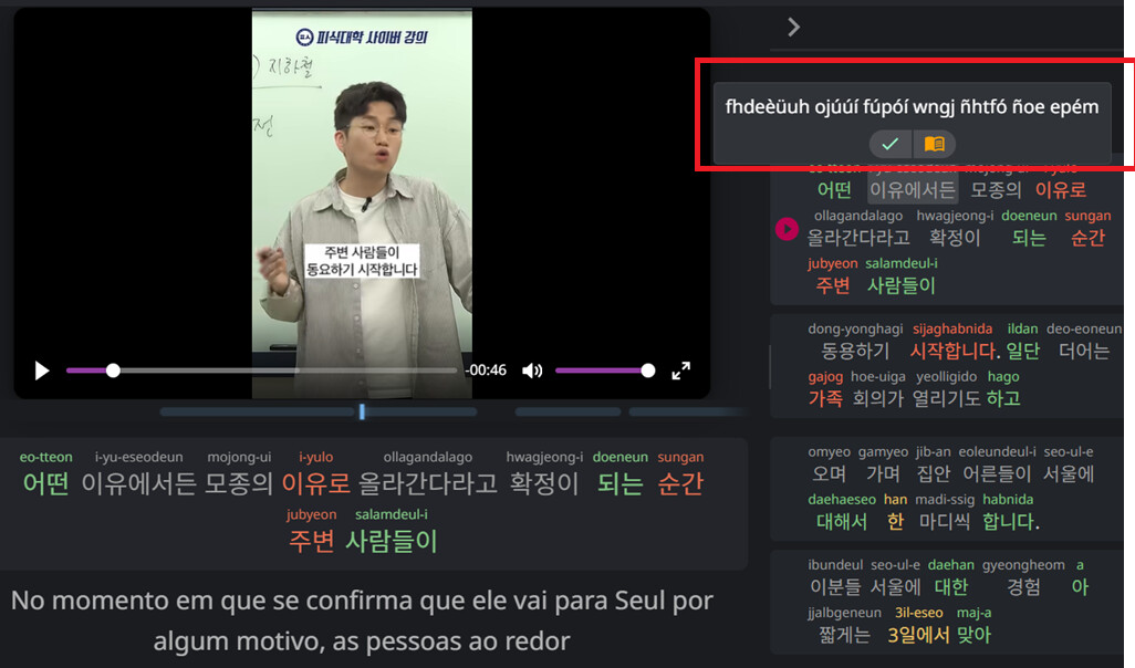

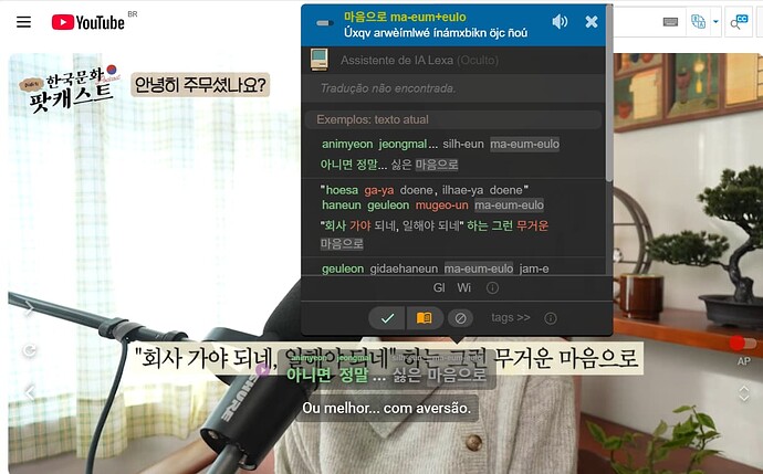

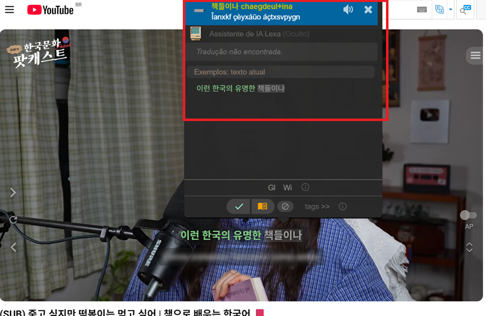

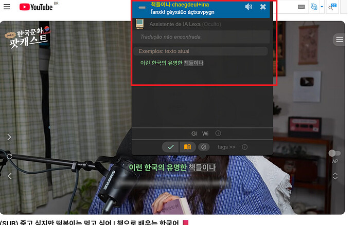

The issue occurs when I click on a word to view its translation. Strange characters appear, the AI feature doesn’t work, and in many cases the screen turns black after I click on a word.
I tested it on 2 computers and the issue is exactly the same on both devices. I also tested other languages, and the problem still persists.

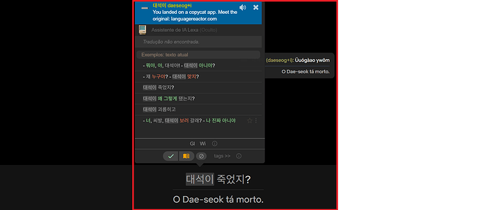

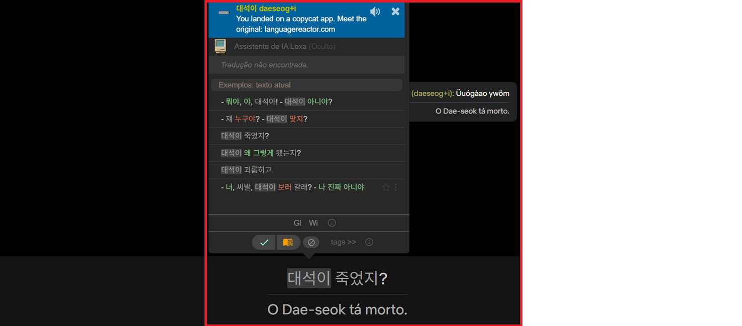

Below are:
In the last screenshot, you’ll notice a message saying that the app is a copycat. However, it was downloaded directly from the official Language Reactor website: https://www.languagereactor.com/.
I checked the Chrome DevTools and found that the extension is authenticated (haveAuth: true), but there is a failed request with HTTP 403: api-cdn-plus.dioco.io/base_lexa_getLexaPrompts
