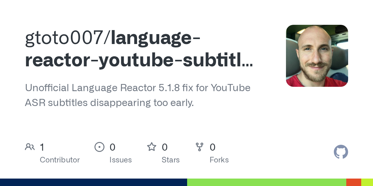

I fixed the issue using Sol 5.6, and it did an incredible job. I published the fix on my github profile (see below) and tested it on macOS. It should also work on Windows, but I haven’t tested it yet. Good luck! :slight_smile:

This is useful. I have already tested your extension on Windows 11. I would like to ask: when the official Language Reactor pushes out a new release, will your extension be updated to keep in sync with the official version?
