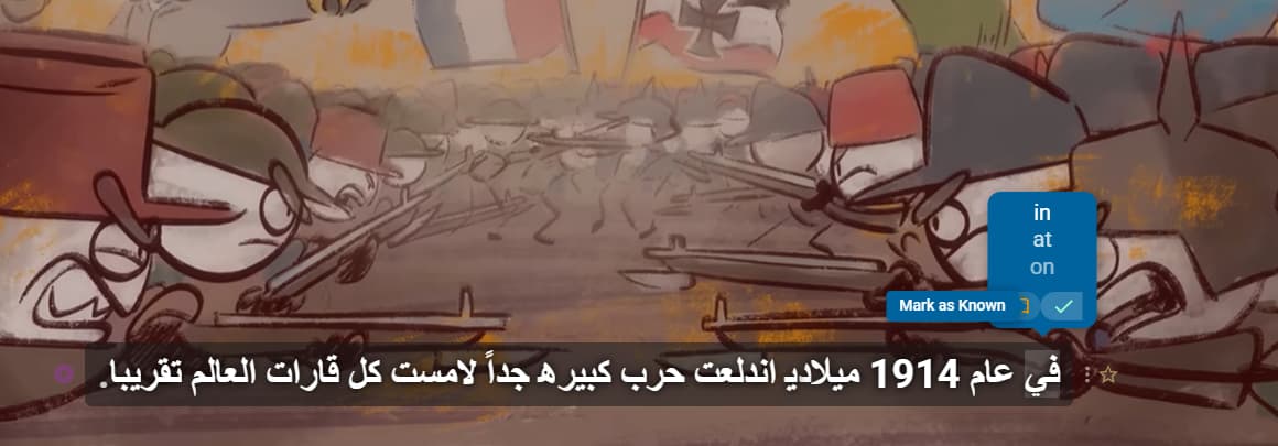

I just bought pro to save words in youtube, but I am unable to. When click the “mark as known/learning” button nothing happens. The star also does not work. I have linked the particular video I was watching but this occurs on any video.

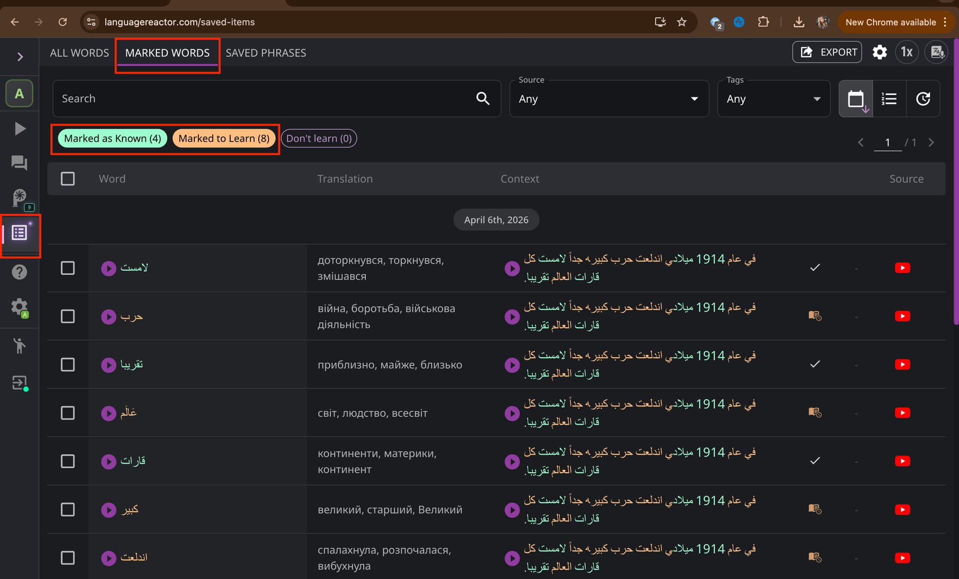

  1. I was able to save the word and phrase from the video you attached. It appears in the Saved section Language Reactor
    If you mark a word as “known”, it is important to add the “Marked as Known” filter in the ‘Saved’ section so that the marked known words also appear in the list (by default, only words marked as “Marked to Learn” are displayed) - see the screenshot below

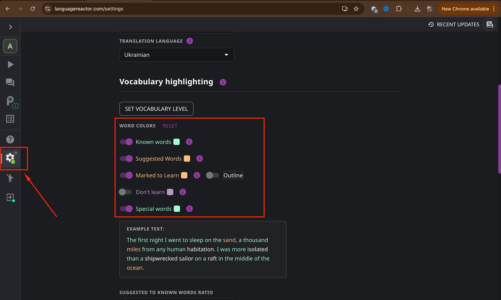

  2. To display words in a different color when marked for easier navigation, you should add color settings for each word separately - see the screenshot below
  3. Please also note that when studying Arabic, the “Mark as Known” and “Mark as Learning” buttons in the dictionary popup are displayed in reverse order. For other languages, the buttons are arranged the other way around, so we should fix this for the sake of convenience.

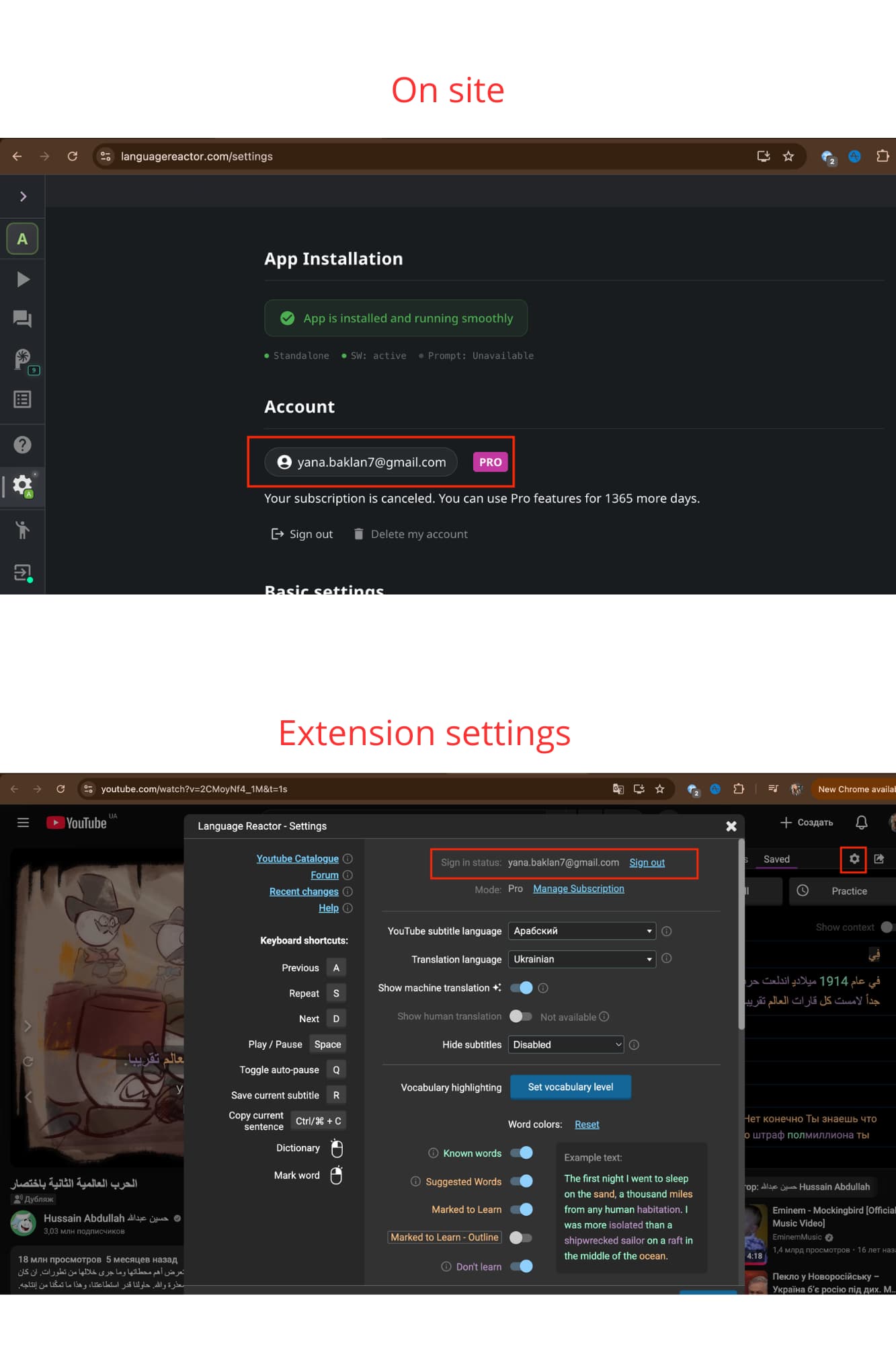

If the words you’ve marked are still not being saved to the “Marked as Knowns” and “Marked as Learn” lists in the Saved section of the website, please let us know if you see any error messages when marking a word and make sure you’re logged into the same account on the website and in the extension—you should see the same email address in the settings for both the website and the extension—see the screenshot below
