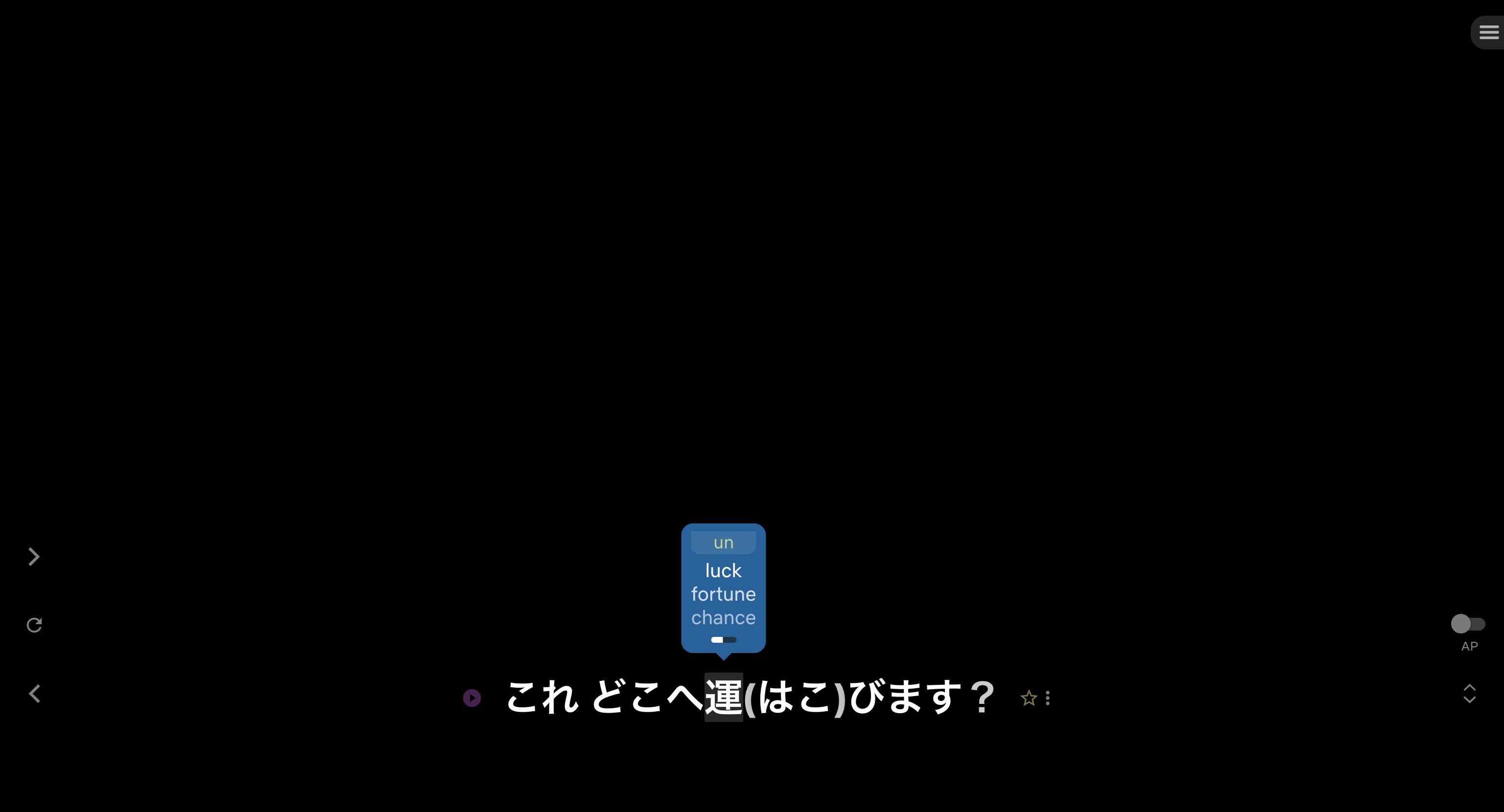

The problem isn’t just that it’s hard to read, it also stops the mouseover translation from working properly. In the image below, the word I’m mousing over is not 運 (un, luck) but 運びます (polite form of hakobu, to carry). It’s getting it wrong because the (はこ)in brackets is preventing it from seeing the rest of the word. If the subtitles have furigana on every word then the dictionary feature basically doesn’t work for that content.
